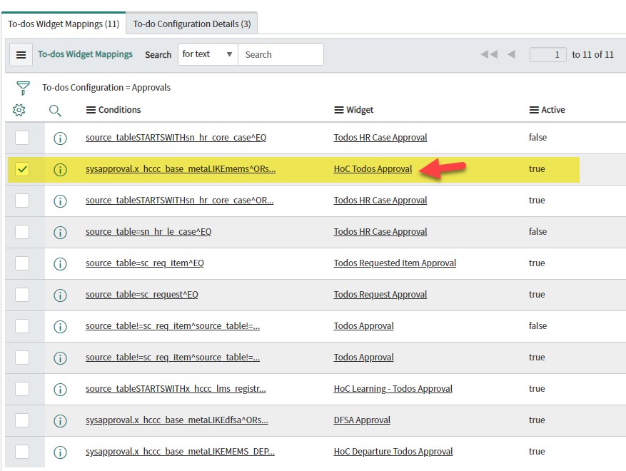

We have created a custom Widget in order to display approvals matching a specific set of conditions. In order to make use of it, we have created a new entry in the To-Do list configuration's Widget Mappings for Approvals /nav_to.do?uri=%2Fsn_hr_sp_todos_config.do%3Fsys_id%3D23fb71a8731023002ceb31d7caf6a7b6.
This works as expected when the approval is displayed from the ToDo list page: The expected custom widget will be used to render the Approval, as configured in the Widget Mappings of the Approval To-Do config
However, when the same approval is displayed from the HR Case, the incorrect widget is used to render the approval (it uses the default one). What's puzzling to me is that in both cases (when viewed from the toDo list and from the HR Case), through script debugging I figured the same code is actually used (getTodoLineWidgetID() from the widget "To-dos task Line Item). So I was expecting the same behavior in both situations.

Hi @Benoît Proulx
Looking at your screenshot of the To-dos widget mappings, you still have an active one for HR Case table source opening in the default HR Case Approval widget instead of your custom widget.  Try to deactivate that record also and test again; or update it to use the custom widget.

Michael Culhan1
I ran into the same issue and put in a support ticket.  Disappointingly, their answer was that the widget structure is different for the task in My Requests than it is in My Tasks, so the Use Widget configuration won't work under My Requests.
