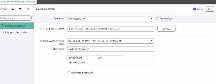

I am reaching out here to get some solution on "to extend the pattern to get the Environment details of servers in my organisation". That details is updated in Registery value of the servers, so I have tried to extend the -Windows OS - Servers pattern.
I am trying to get it via Get Registery Key Operation, but not able to sucess.

SiD2
Hi @Ashupakasma
I see you are directly using the actual win server cmdb ci name itself in the registry step, instead you better use a temporary value and then copy it to actual CI in different step.
Though you did it, still I could see the env value is set in CI attributes section in 6th image, so what is the concern here that its not working.

Hi @Ashupakasma
You should not change the source table name in steps 8 image, keep the source table also as win server CI name.
Once you do above change, in debug mode go to next step and in right CI attributes view you should see all the win cI attributes filled properly

Hello @SiD2 ,
Thanks for your prompt reply on my query. I am attaching here the steps that I followed till now.
Image 1st, is the requirement, on which I am working upon.
Imgae 2nd, is where I have created an extension under-Windows OS server
In third step, I have tried the operation"Get Registery Key"
In 4th step, I get the environment details.
5th and 6th steps, I am trying to get the desired result, according to my requirement, but not getting success.
