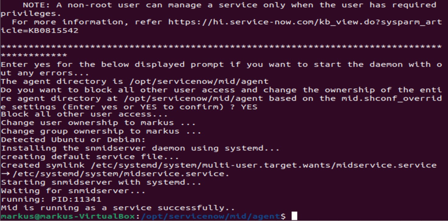

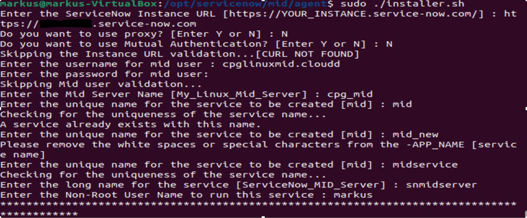

When setting up MID Server under Ubuntu the configuration get's stuck in the last step: Validation of the MID Server in the ServiceNow instance.
I have checked time zones on the ServiceNow instance and the VM hosting the MID Server, both are the same.
I have invalidated and restarted the MID Server and validated again, still the "Validated" value is stuck in "Validating".
I have stopped the MID Server and reinstalled again. Still the issue is that same.
When reinstalling I followed these steps shown in the screen shots.find_real_file.png
Any hint is much appreciated.
