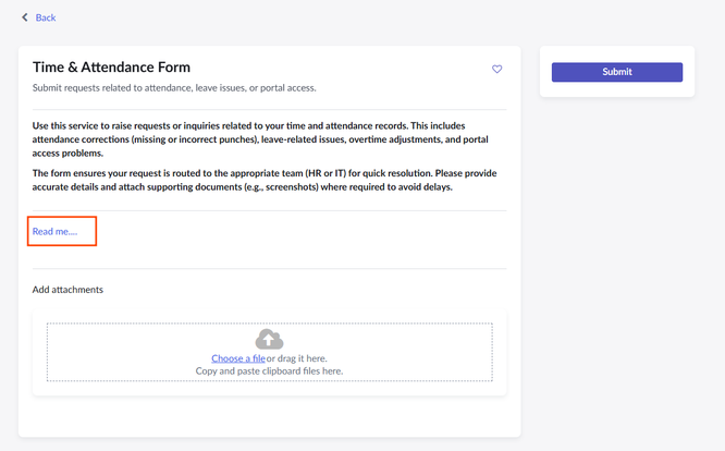

Sadique Ali Kho
Hey @pathumharsh ,
You can use a Rich Text Variable as per steps in screenshot
Step No.1: Create Varriable
Step No.2 : Add Link
Final Result:-
Kindly Mark Helpful
