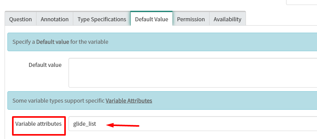

I have again tried the code and it is reflecting for me. If possible then please check the variables name properly and try to put alerts in your code and see if the values are coming correctly:
alert('ids are '+ids);
If possible then set the attribute value as glide_list for your variables. You can do it in below place.
