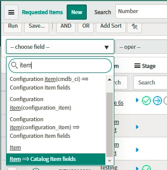

On Requested item table, on 'Item' field I have applied reference qualifier as a active true.
so while searching on RITM form, it is showing only active catalog item. However If I am applying filter at requested item list for item field then there they are showing all catalog item(including active inactive)

04-27-2022 11:16 PM
if you are saying you are applying filter using table list like this and it's not working then it is expected by design
Ref qualifier work on fields when they are edited either on form or on list
Not when they are used in filter conditions
