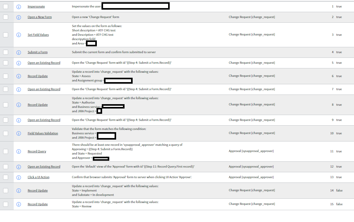

I might be late on this, but I have used the below steps to produce a change and move it forward in state. Hope the Screen shot below gives you an idea
For the approval process, As Dean has described, make sure that:
  • The person you are impersonating has approval role
  • When setting up the Open an Existing Record to approval form, make sure you also add the "default" view. I didn't do this at first, and got an error and the change did not go through the approval process.
