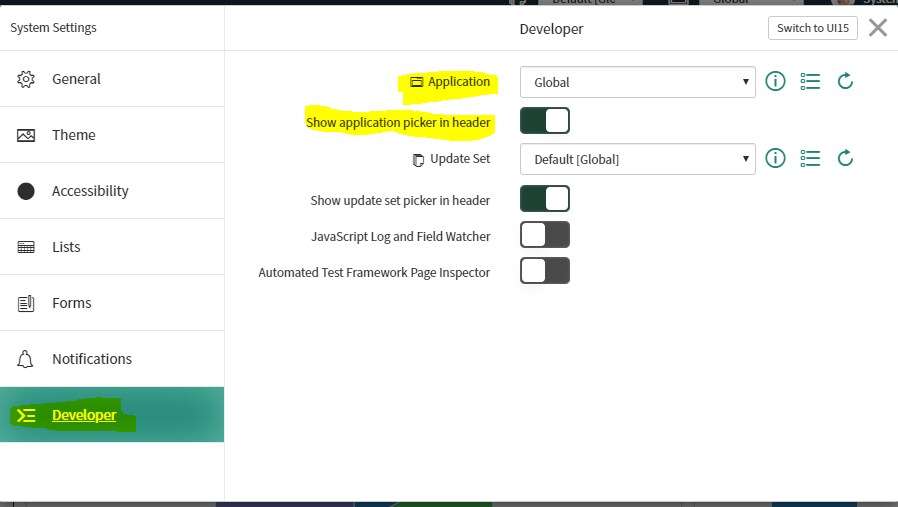

check the application scope , make sure you are in correct application scope.
have you checked the view ? are you in correct view ?

Mohit Kaushik
Hi Nagraj,
You need to check the application scope and view of the form whether you are in correct view or not and the scope as well.
To check the application scope. Match if your current application scope is same as your form's application scope.
2. Form view you need to see if it is correct view in which you are doing modification. Easiest way to modify the form is FORM DESIGN. There you can see the fields in proper section as you see in your form and you can drag and drop it from there.
3. Check if there is some security Rule which is not allowing you to perform this function when you are in correct application scope and view.
Please mark this answer correct if it resolved the query and mark it helpful too if it helped you at all
