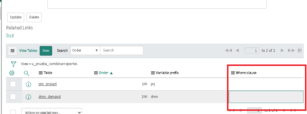

Hello friends! I'm trying to set up a database view with demand table (dmn_demand) and project table (pm_project) because I need to sum some demands (filtering states) and projects without demands (demand field: empty) in order to show it in a report.
I don't know how to write the right "where clauses" to make this work.

To join Project and demand table you have to use the common field.
example - Project have demand field, you can use in Demand where clause.
prj.demand = dmn.sys_id
For more details refer docs - Database view creation
