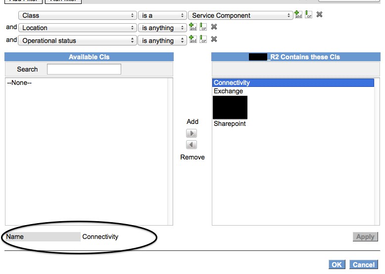

‎11-04-2011 02:32 AM
whee would I customize the fields displayed in the slushbucket of the CI Relation Editor for a selected element (see below)?
I would like to show some more information that is available in the cmdb_ci base table, so avialable for all CIs.
I have looked in the "ci_relationship_manage" UI Page but have not found it...
‎11-04-2011 05:15 AM
You're limited to fields from whatever table is being queried so you can only pull fields from the actual table that is being queried as far as I know. You can personalize these options by following the instructions here.
http://www.servicenowguru.com/system-ui/customizing-slushbucket/
‎11-04-2011 05:45 AM
Thank you Mark! That was exactly what I was looking for ... 🙂
