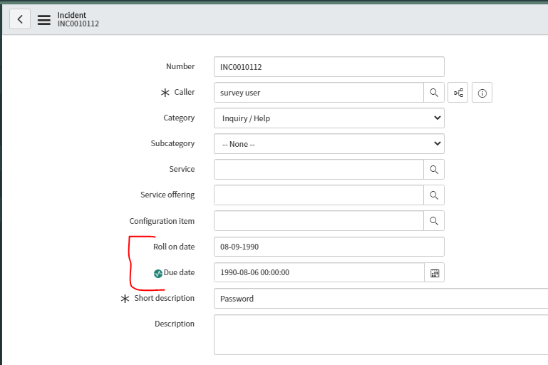

Hi Eric,
could you please double check your roll on date field if it starts with u_ if it's a customized field?
I tried the it on my instance and it's working fine. I've created roll on date field on an incident form and applied your logic in the flow designer - it saved and executed as expected. see below
And when i tested this flow on one of my incident bu giving a roll on date in string format as shown below - it executed the script and applied it to due date field as expected.
Also it might be worth double checking if your "roll on date" field is on the right table you are creating your flow designer for.

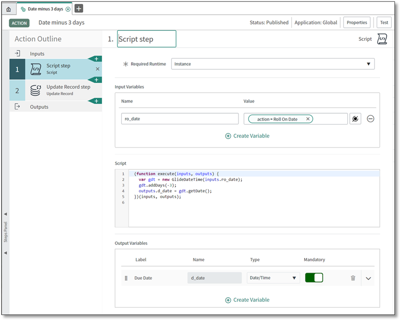

@Arsh I was actually passing a variable from a catalog request item. Not one added to the structure of one of the OOTB app form/tables. So, perhaps I should have tried something like:
  • fd_data.trigger.current.variables.roll_on_date, or maybe
  • fd_data.trigger.current.variables.req_item.roll_on_date ??
What I did was just to create a separate action, and call it in the flow.
The action, defined
So I didn't actually answer the inlline script question, but I did figure it out. ????
