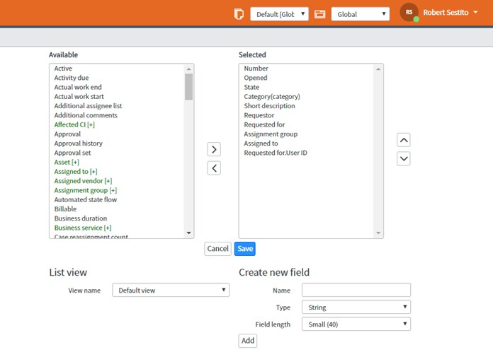

Okay - I am going to try and explain this as best as I can in hopes to ask the right question.
While looking at List View, having all your columns. I wanted to create a Column that can display employee's company ID number. Now, while in a Case, there are Tabs called: Case Notes/Related Knowledge/About Employee/Employment Information/Contact Information. In the Employment Information, the "requested for" employee's ID number is generated. Even when filling out a Case form, we are able to search for an employee by their name and or ID number. So I know the system is configured to see/find/generate the Employee ID numbers.
What I am looking to do, is have that ID number, be it's own column when looking at the List View of all cases. That way, I will be able to generate reports using the employee's ID numbers.
As of now, I did create a new column called Employee ID Number. But I am stomped on how I can get this column to look at the employee ID number and show it in the column.
Anyone able to understand what I am looking for and possibly help?
Thanks so much in advance!
-Rob

Hi Robert,
It sounds like a simple case of dot-walking. You can place the field from a related (reference) record on the list using Configure> List Layout. If you want it on a report, then you can do something similar in the report field layouts.

Thanks for replying Chuck - and yes I know how to dot-walk. I have the column I created for Employee ID Number. However, that is not looking at anything to generate the numbers.
but wait - I think I found it.. When going to the Configure Form list, and looking at "requested for" - that option has the added extensions drop down menu. And I see "requested for.userID". that may be what I am actually looking for!
I will test that and let you know if it works. I had already "added" it to the form, but when the form refreshes, it's not showing the change.
-Rob

Were you adding this to a list or a form?
What needs to happen when the form refreshes? I'm not entirely clear of the requirements, Robert. Screenshots would be helpful.
07-07-2017 07:01 AM
Sorry for the confusion Chuck -
So I am going to List Layout:
Then from there - I already found the "Requested for.User ID" from the available section, and added it to my selected List section.
But after I save it - Requested for.User ID still does not show up when I go back to my list view.
