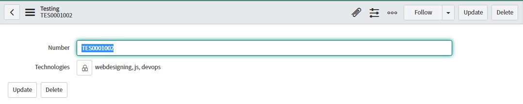

I have a list type field, it is not referring any table instead having choices. Once the form is saved, the field is showing values instead of labels. I need to show labels there, I have gone through several community posts, but didn't find any soultion.

Hi Ajay,
Was this field previously reference or choice from beginning?
please share screenshot

Hi Ankur,
It is custom field created on custom table. I have created it as Type: List, choice list specification: drop down with none and added choices to it.
Now on the form, when i select the choices, it is initially showing the labels, but after saving the form it is showing values. I can't make Label and Choice look same, because I have labels with slashes and long strings.

It worked fine for me.
Is this happening for all records?
share the record screenshot after record is saved
