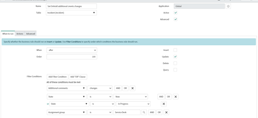

I have created a business rule as below:
When
additional comments :changes
State is New or In Progress
Assignment Group: Servicedesk Team
Actions
Set field value State to "On hold
On Hold reason :Awaiting Caller
Thing to be achieved: Whenever Argent add comments, the State will automatic change to State On Hold , Reason  Awaiting Caller.

Hi @Yee Man Chun ,
Use create after business rule and check Update on When to run Tab. use below script

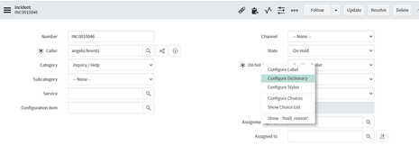

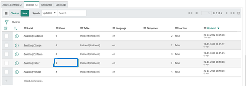

Hi @Yee Man Chun ,
As I shared comments in code you need to give the correct backend choice value of On hold reason field.
To check the values right click on the field and configure open the dictionary.
Refer below screenshots.
You need to provide your choice value in above you can see for Awaiting Caller value is 1.
if you provide correct value for On hold reason it will update.

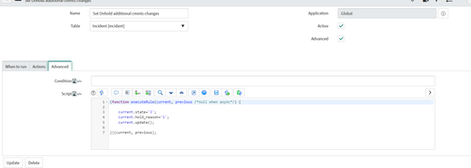

Hi @pavamkumar4,
I think i follow exactly the same as what you mentioned but the status will only change to on hold , reason (none).  Could you help me double check if i did anything wrong?
