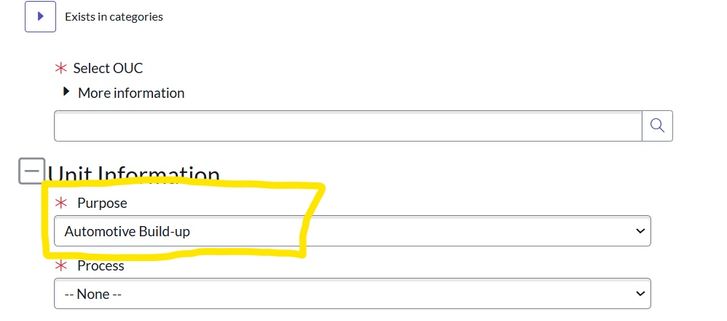

Requirement:- When user select "Purpose" field as 'Automotive build-up' then above "Select OUC" all value should be clear and only shown some specific 6 records from that table after click on magnify glass icon, there is already configure Reference Qualifier query. below ss are available for reference.

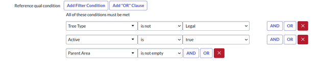

existing query on reference qualifier.

I have to also mentioned the existing reference qualifier query with the above requirement, which I mentioned in the post. How should I do?
