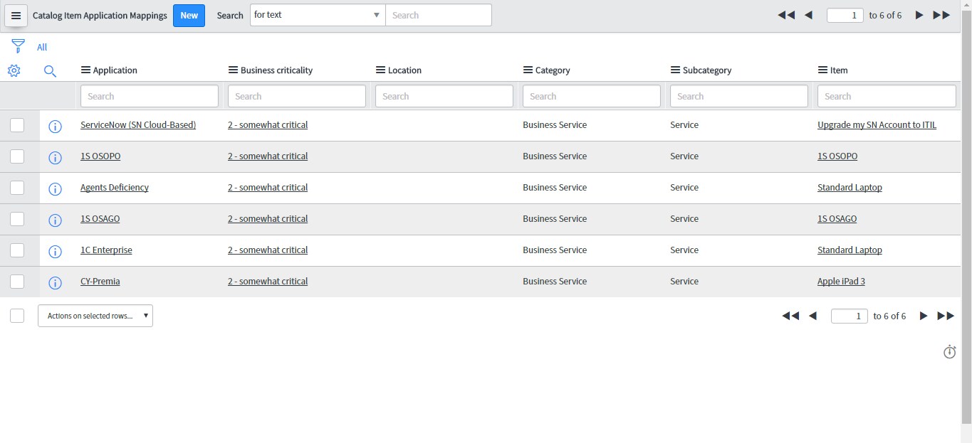

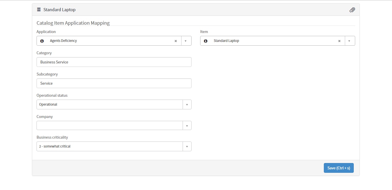

I have combined the cmdb_ci_service and sc_cat_item table in to a custom table and i have used that custom table in service portal search source to provide search results from both of the table. when i tried to search, it displays the search result and if i click that search result link it navigates to the custom table form view but i need to display the catalog item order page.
custom table:-

Custom table Form view:
I need this order page view:

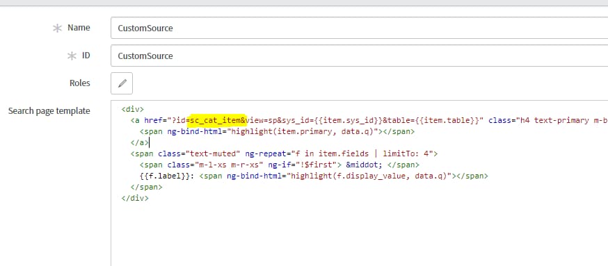

Seems you want to change the page in which search result opens.
Changes against Search Group
1. Search page template make below change
2. Scroll down on the search source and switch to tab typeahead and make below change
