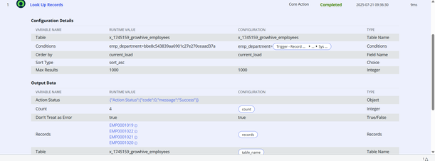

Step 1: I used a Lookup Records action to fetch employees based on certain conditions (like matching department and lowest current load). This part is working correctly, and I’m getting the desired output.

Hi @saibhanuala ,
you can use the Look Up record action instead of (look up records action)
with department condition
where table name is employee table name and order by current_load (a to z) low to high
here is an example on the incident table
you can use the datapill and directly set the assigned on from the lookup record action
with look up records action you have to use for each action to access but with this you don't need extra step and your requirement suites it
hope this make sense

Hi @saibhanuala ,
This can be achieved directly without using script also. You can utilize the if employee in department found->true-> assign the employee sys_id from data pills to respective case-> end . This will be much smoother and easier. If i miss something, pls attach the snippet for better coverage of answer.

You can use "Update Record" flow action and set the Assigned To as Output from Step 1
share screenshots.

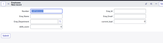

I have a table named ContactandSupport which stores reports raised by customers through my app. From the frontend, fields like Department and Subject are submitted by the user. There's also an AssignedTo field, which is a reference to another table called Employees.
Employees(Table)

I used the Look Up Records action in Flow Designer to fetch a set of employees belonging to the selected department.
I am able to retrieve this list successfully using a Data Pill.
Issue I'm Facing:
Now that I have the list of employees, I want to update the AssignedTo field in the original report with one of these employees (preferably the one with the lowest current_load). However, I’m not sure how to take the output of the Lookup Records step and use it to update the record.
