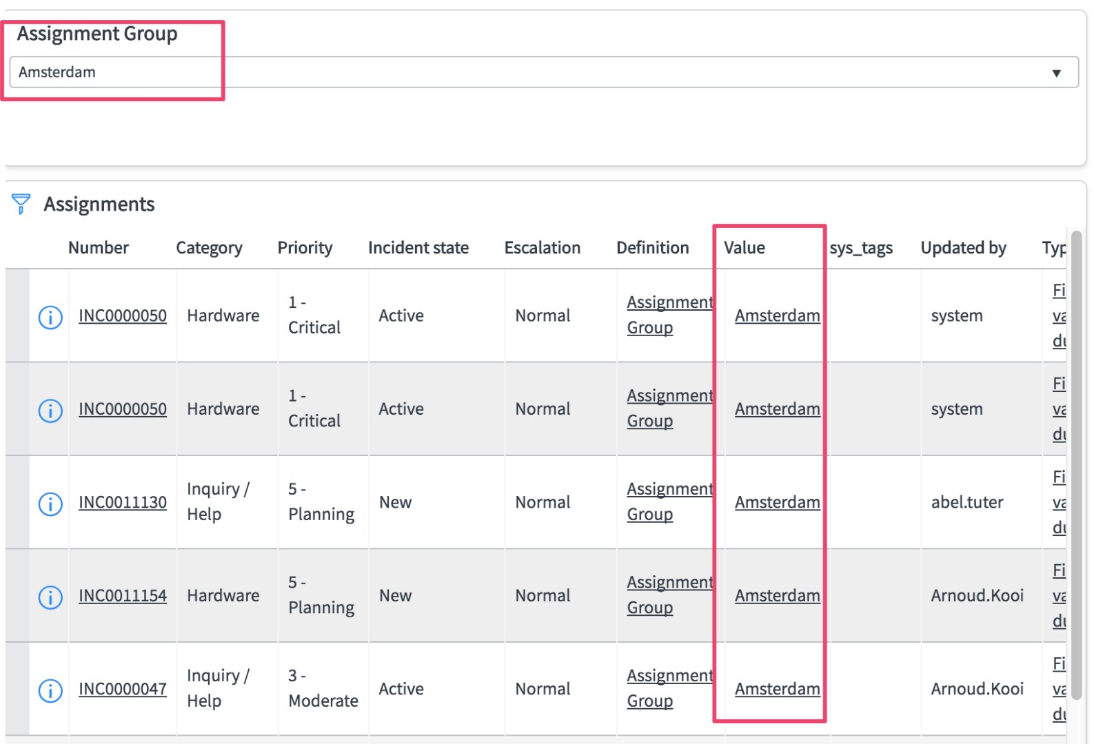

The Metric Instance table, does contain a field with the sys_id of the assignment group: mi_field_value.
Because the fact this field is not a Reference to Group, you can not pick it.

I have tested this on my instance:
Thanks Arnoud!
So the Interactive filter Assignment Group is mapped to the "Value" field? IF so, amazing.
