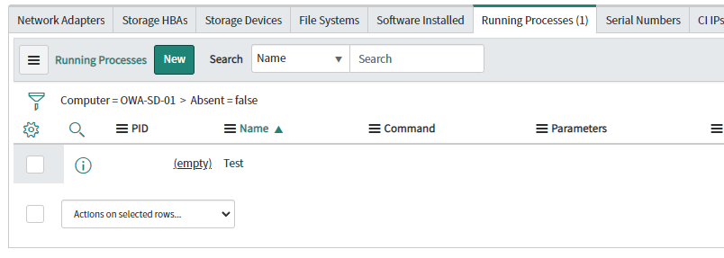

You can use the related list condition in the report builder to achieve this. In my PDI I created a running process called 'Test' linked to just one server:

I'm taking it then you want a list of all servers that have running processes against them, but exclude any where the only running process is "Test", if my understanding is correct then you just need to adjust the related list condition:
Update the condition to use 'Greater than or Equal to 1' and then the name is not the name of the process you want to exclude
I included adding running processes to 3 servers, OWA-SD-01 has Test and ServiceNow as running processes, SAP LoadBal01, just has ServiceNow as a running process and PS LoadBal01 has just Test as a running process, as you can see it brings back the 2 expected results
