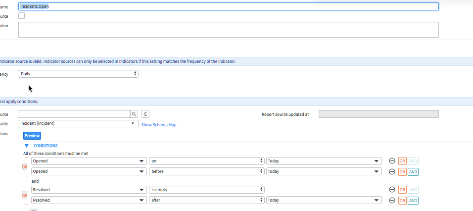

This is the indicator source and one of the indicators. Thanks for looking into this.

The restrictions are on the indicator source, not the indicator.  Add (at least) the active condition to the source.  This source should also be time-boxed (look at the OOTB examples) to ensure it is historically safe.  This one will get you intro performance and potentially data issues (if you try to use it historically).
Thanks Adam, this seems to resolve the problem.

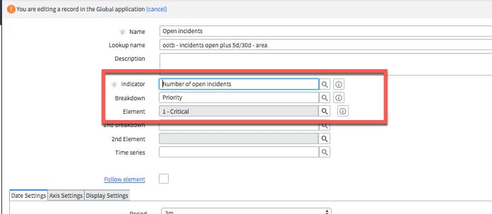

If you used the OOTB Indicator Source (Incidents.Open) for incidents and leveraged the associated a breakdown by priority, it would be much simpler from an administration/maintenance perspective.....not to mention provide you with a greater level of flexibility if you wanted to report on other attributes.    Example Setup below....

Indicator Source

Indicator - this indicator is set up to only display Critical Priority Incidents
Example Indicator
