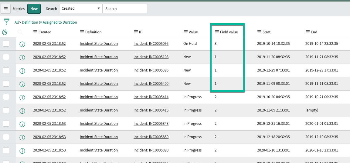

Adam Stout
Use Field value instead of Field:
I was using the 'Value' field not the 'Field' field, however, I did modify the breakdown script to use the 'field_value' field to lookup the choice list sys_id as in the below script:

Adam Stout
Sys_choice is a special field.  You may be double converting since the system auto converts the value to a sys_id in the data colelctor.
Try it without the script (just using the mi_field_value) and see if it work.
That did it!  I am now pulling scores for the States.  Thank you very much, Adam.
