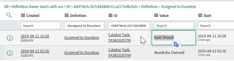

I would create a new field in table where I would store time taken to assign using script.
However, you can also try to use metric_instance table where you have definition like Assigned to Duration.
You will know that first assignment was to Yash but still need to calculate time between Start and Creation of ticket itself.
