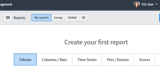

Once I submit the record producer notice Beth now has ITIL Test in her list:
And ITIL user does not:
