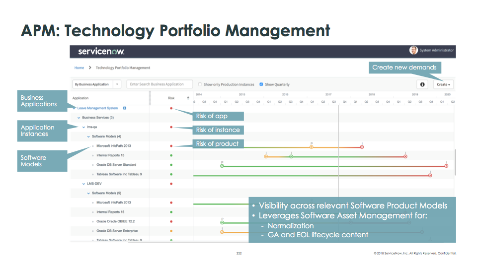

Do you have APM by chance?
SAM + APM "Better Together" use case.

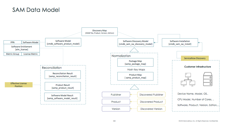

Here is a snip of the SAM data model
