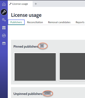

What table do the Publishers that show up in the Software Asset Workspace under the License Usage tab reside on?
How can I get a list (count) of the Publishers that show up under the License Usage Tab in our Software Asset Workspace?
I need to create a report to add to our dashboard. I've looked at the license position report and cannot isolate just the number of Publishers, it only brings back a count of all Products...any ideas on what table the Publishers that show up in the License Usage Tab are pulled from?

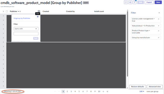

@Carolina Messer I was able to match the Publisher counts in the License usage (under Software Asset Workspace) using the Software Model table [cmdb_software_product_model] with the following filters (Group by Publisher):
License under management = true
Status = In Production
Product.Product type = Licensable (dot walk to Product type)
