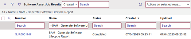

If I'm not mistaken, the next step is to generate the records in the Software Lifecycle Reprot table via the Job "SAM - Generate Software Lifecycle Report", trying to run it does not create records in the table, it seems that the Job lasts a few seconds and ends, I attach a screen.
It seems that the Job crashes at startup, because from what I know, when the Job starts the Software Lifecycle Report is emptied and then the records are created, in my case the table is not emptied, nor are the records generated.
Do you have any idea why the records are not generated in the table?
