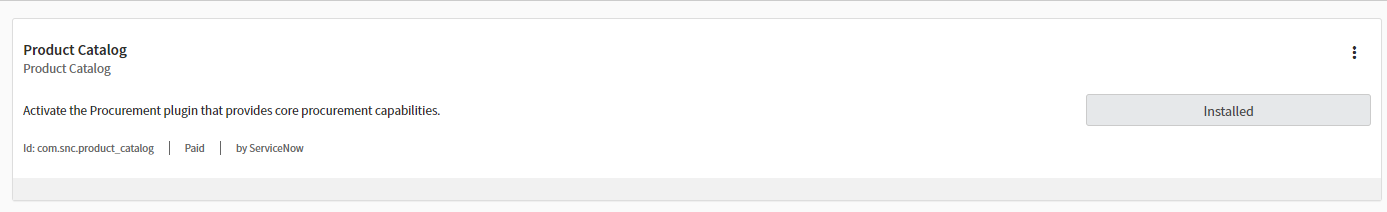

jordanm
Kilo Contributor
Thanks for the reply Sulabh. Unfortunately, I've search for terms 'models' and 'product' and don't see this showing up.
What's interesting is that Product Catalog does not show up at all yet, I checked plugins, and see that it's installed.
