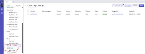

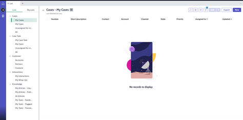

I'm currently working on CSM/FSM Configurable Workspace. I noticed that admin users can see all UX Lists and Categories, but when testing with users who have roles like sn_internal or sn_customerservice_agent, some UX Lists do not appear in the Workspace.
Here’s what I’ve confirmed so far:
The UX Lists and Categories are properly created and active.
The tables used (e.g., kb_knowledge, kb_feedback) have ACLs that seem to restrict access based on roles or KB version.
If I add a UX List to a Category that’s already visible (e.g., “All Articles”), the list becomes visible to non-admins too — so it seems related to permissions or ACLs.

UX lists have an 'applicability' record where you can set who can see what (sys_ux_applicability_m2m_list).
07-31-2025 12:24 AM
Did you create the correct audience with roles to it?
Does your user satisfy that role?
Each UX list has an associated list applicability and the mapping between those is stored in this table
"sys_ux_applicability_m2m_list"
Open the Applicability associated to your UX List, check if your non-admin satisfies that role or not

Thanks! I’ve checked and confirmed that the issue was indeed due to UX List applicability settings. Really appreciate your help!
