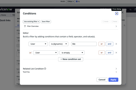

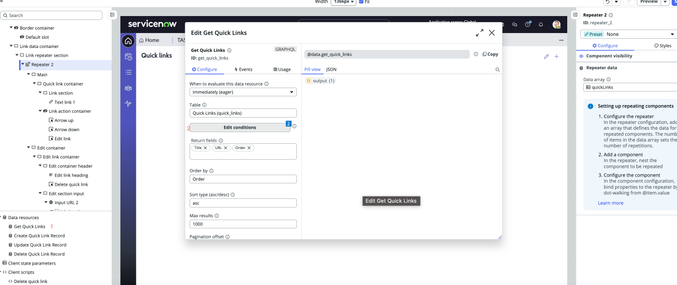

Gangadhar Ravi
@JLeong It is coming from quick_link table. You need create variant for Quick links subpage and  then update filter in data source as shown in below screenshot. this is just example you can modify as per your requirement.
Please mark my answer correct and helpful if this works for you.
