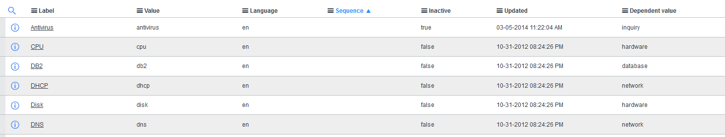

This is how the category and sub category are related
and in choices you need to fill in the dependent value as shown in the below image
So in your business service category add a dependent field as Business service
