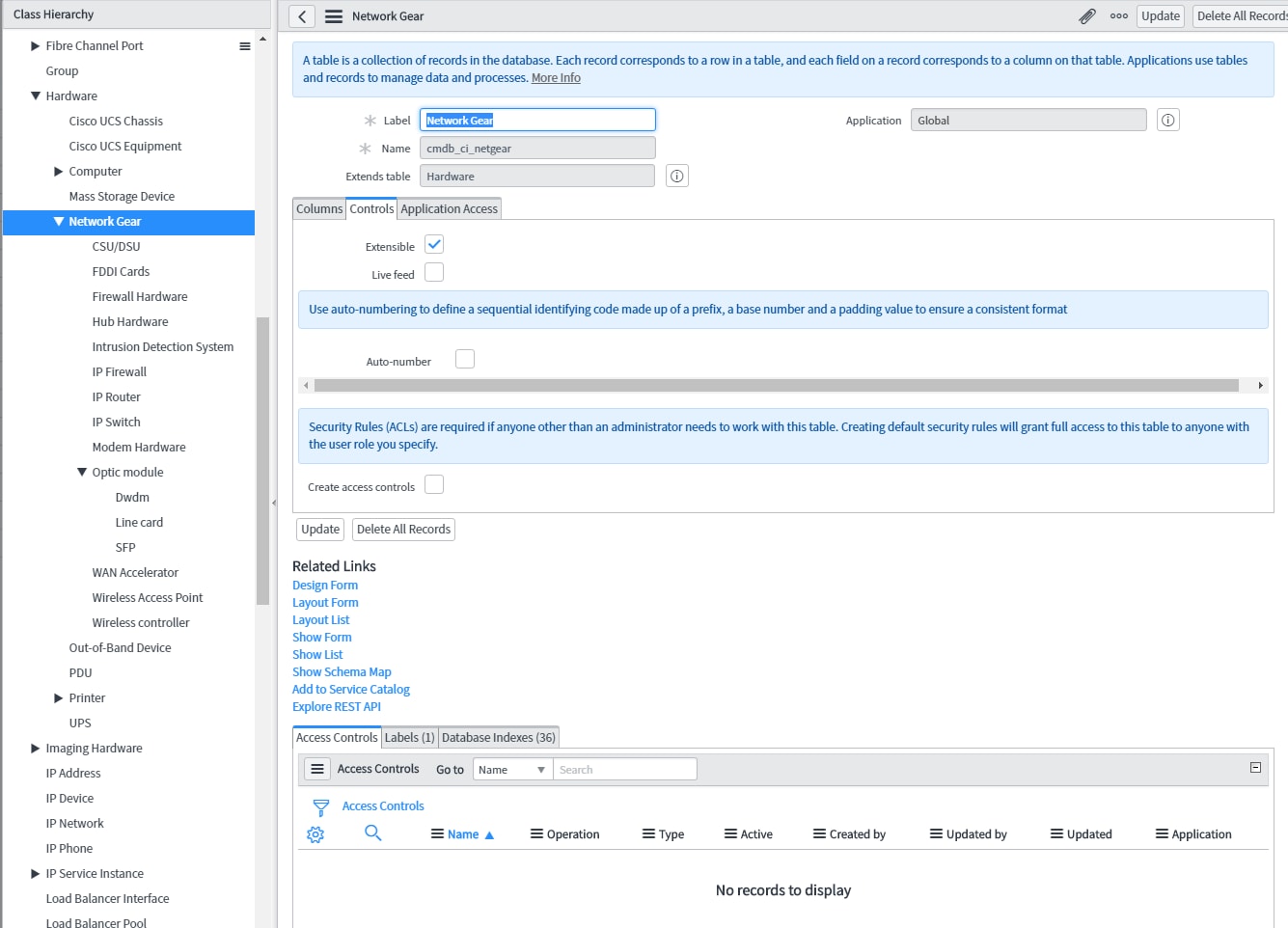

Here's what it looks like now on a table that extends Network Gear. Do I need to specify ACL here (where it says itil now - Fig. 02)? And what happens if I delete these 4 access control rows?
Fig. 02
Compared to Fig. 03 that Optic modules is extending from the ACL list is blank. Does that mean that it gets the access rights from the table that this table extends from?
Fig. 03
Basically, what I'm looking for is as few ACL's as possible in order to manage them easy for all the Configuration items. Anyone with good ideas?

Hello!
What about ACL already defined in the screendums. Can I delete these since they all extend from cmdb_ci in in some way without users beeing locked out from these modules? The GUI sais: "Security Rules (ACLs) are required if anyone other than an administrator needs to work with this table. Creating default security rules will grant full access to this table to anyone with the user role you specify.".
One tidbit of advice:   Don't delete the ACL's. Instead, set the active flag to false.     Same effect as delete, but you can easily undo it if needed.
We create ACL on a table when we want to limit the access of users on certain tables. For example If I want that users with role itil can only write into incident table.so I will put a write ACL on incident table for this role
