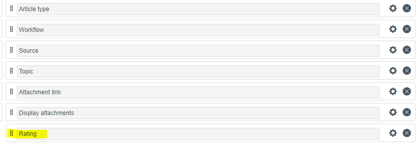

3. In the record go to form design and add the rating field

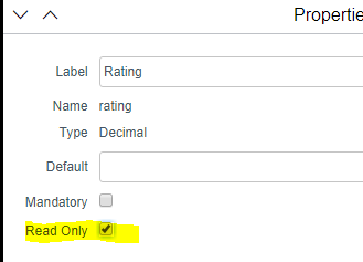

4. While still in the Form designer, with the Rating field added click the options and uncheck read only.
5. Save the form then go back to the KB in admin view, the rating box should now be there and you should be able to delete the numerical value associated to it.
6. Follow the same steps for the view count.
