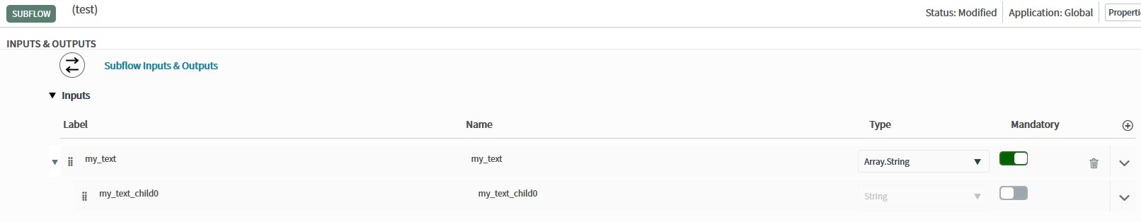

I have created a simple subflow with an input type of array.string:
Is this type not an array of strings? Perhaps I'm misunderstanding it or forgetting something obvious. I then have a For each logic action so I can loop through this array of strings:

Well I don't necessarily need an output. I went ahead and defined one although I'm not setting the output in my example I shared. What I am unable to do is print the value of this input type (what I think is an array of strings) to the log. The test doesn't even show that I provided a value at runtime, and I did. I feel there's something fundamental I'm missing here...
While I see null in my original example, the past few tests I see:
"my_text": {
"my_text_child0": [
Again, I provided a value prior to running the test.

Your flow looks good. I just tested the same on my side as well and it works. I would suggest deleting the existing input variable and recreating it that might solve this problem. I observe this many times recreation fix these types of issues in flow designer.

I executed cache.do and then completely recreated a separate Subflow to test. I once again gave one array element a value and ran the test. Once again got an empty string even though I entered a value prior to running test:
So then I repeated this on a PDI and same result. Am I do anything wrong with how I'm entering the test value? Here's the latest test:
