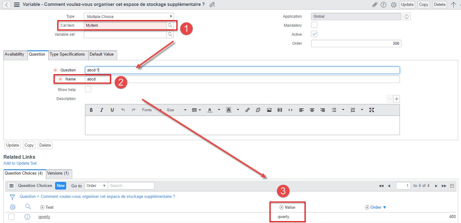

Hichem
Mega Expert
Here is the catalog variable :
And here the catalog client script :
What can be double checked more than that ?

Just wanted to comment on this that there may be several different issues being discussed here:
I think Hichem is talking about the issue that   g_form.clearOption, g_form.addOption and g_form.removeOption (and g_sc_form.removeOption) do not seem to work for a multiple choice variable in the service catalog in Helsinki (I've tested all of them in my Helsinki demo instance and none of them do anything to the multiple choice variable).
Hichem, did you find out anything from SN on this?   I have a client that is using DOM manipulation and of course now in Helsinki it doesn't work and instead of reinforcing bad script I would like to write the script the proper way.
