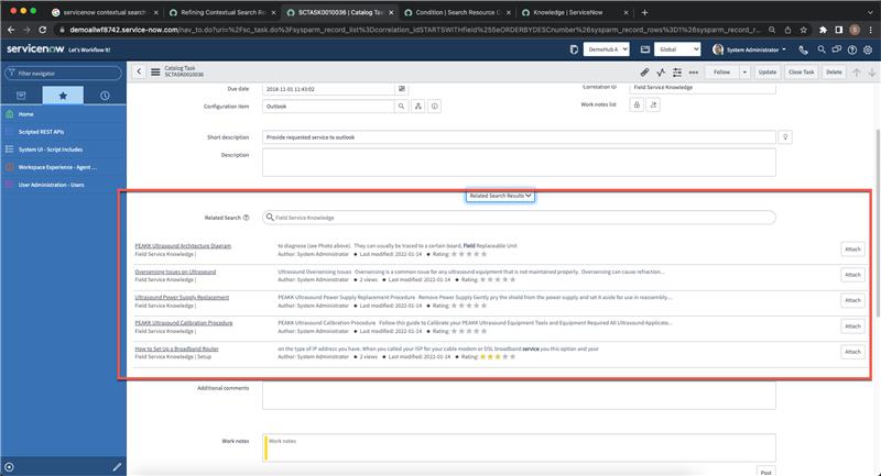

  1. This would populate all the articles on the particular knowledge base on to the form
The below example shows all the knowledge articles from a particular knowledge base on a catalog task using the above set up.

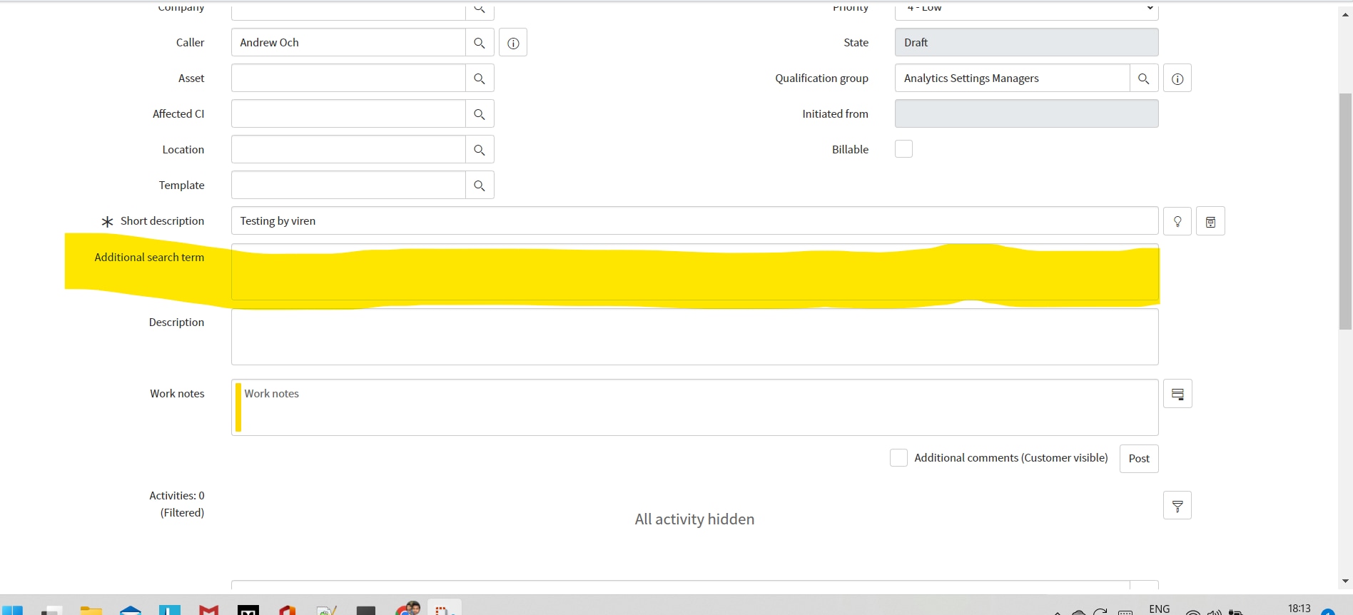

Hi @Abhijit
I have done as suggested by but still I cannot see articles on form .
