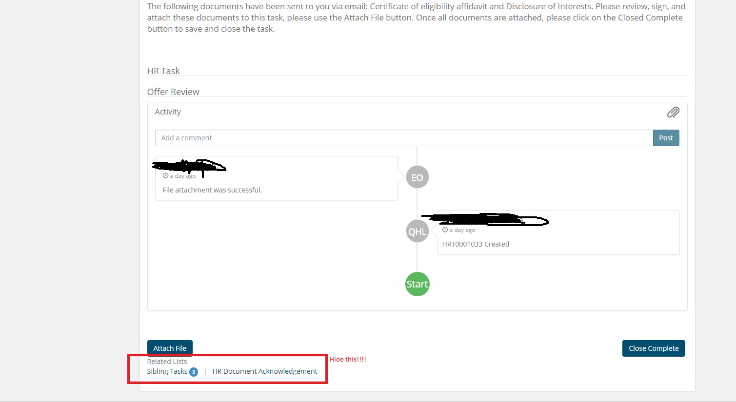

Hello ,
Have anyone came accross hiding the related link on service portal
PFB, I want to hide related list
It was not there while we were on Helsinki but started appearing on Kingston.

Hi sushant007,
Since the OOTB form widget already allow to display or hide the related list links.
We can see in the HTML this line:
<div ng-if="!data.hideRelatedLists">
And on the server script:
data.hideRelatedLists = options.hideRelatedLists || false;
So in order to hided the related list links, I recomment to add this piece of code in the field "Additional options, JSON format" of the widget instance:
"hideRelatedLists": {
"value": true,
"displayValue": ""
Form widget
Form widget instance
Ximizu
Senior Consultant
https://ximizu.io
Hi @Ximizu
I added below code in "Additional options, JSON format" of the widget instance and struggling to understand why it isn't working.
"value": "true",
"displayValue": "true"
But I changed to what you mentioned and it worked. Thanks.
