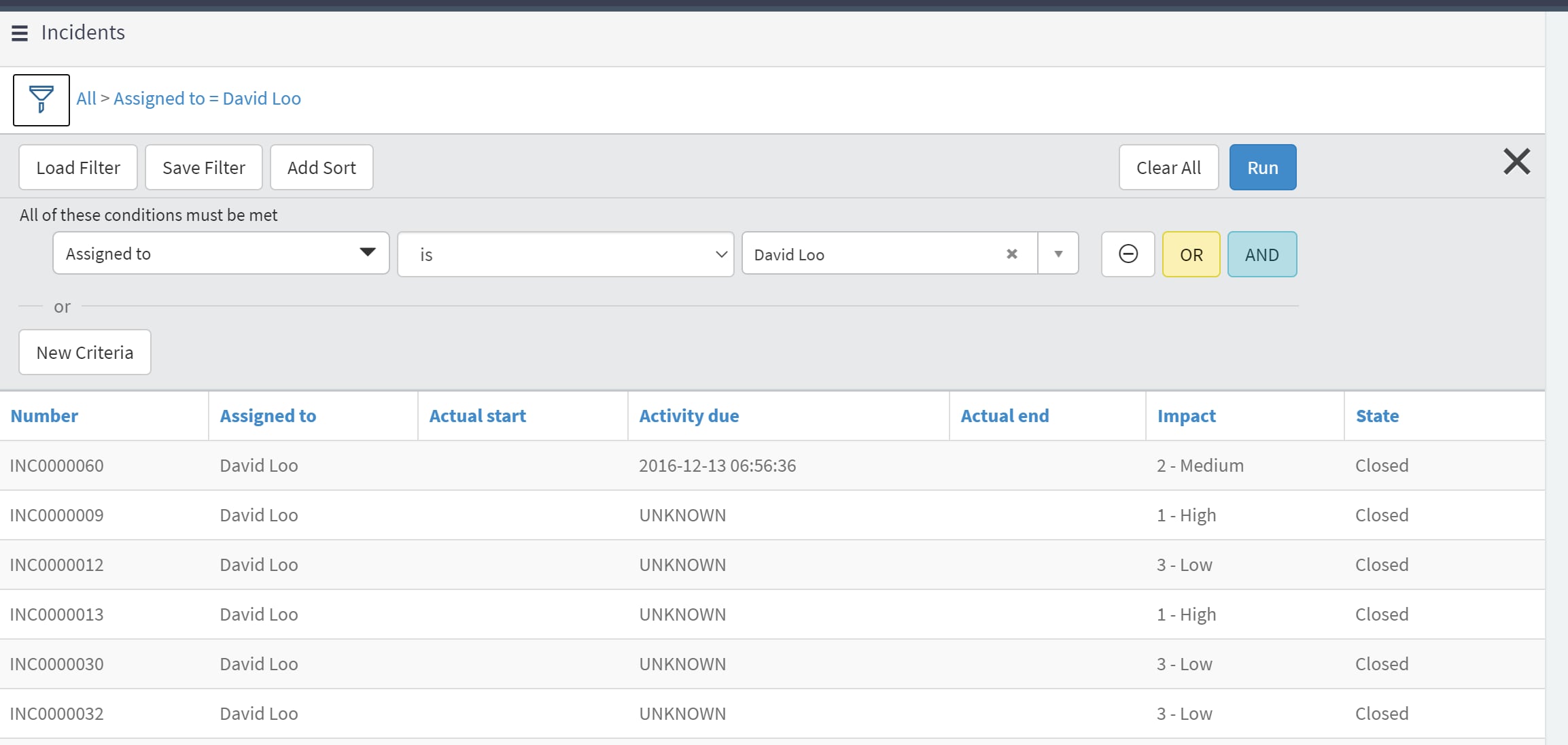

If you're trying to show a data list, with the filter options at the top, you should probably use the "Data Table from Instance Definition" widget on your page. You can select the table, fields etc. that you want the widget to show, and as it has the filter widget included, and everything set-up to be used readily. All you need to do is to pass "enable_filter: true" in the widget instance option on the page, and it should show you the filters, and the filters will work without you needing to make any explicit changes.
Please refer to the screenshots below for reference:

Thanks a lot Rishabh. Now it works as expected.
