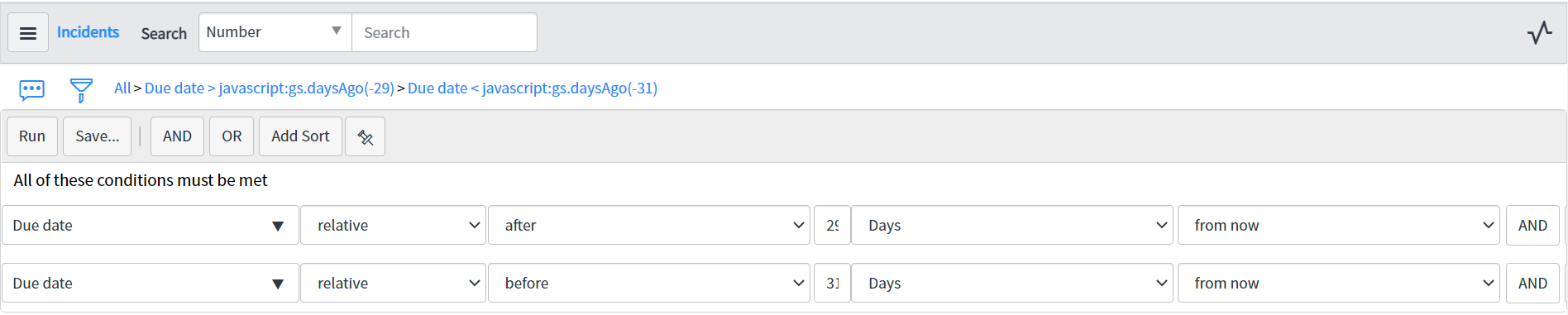

I want to write filter condition of date after 30 days from now, please help me.

You can achieve it like below, the digit in the image is not clear, I have added it is 29 and 31. The logic here is "Due Date after 29 from today and before 31 days from now" which will give us records where due date is 30(after 29 and before 31 is 30) days.

It is not giving exact after 30 days, giving middle dates as well, I want exact after30 days

In that case just keep the 1st filter & change the 0 to 30 days & remove the 2nd filter
