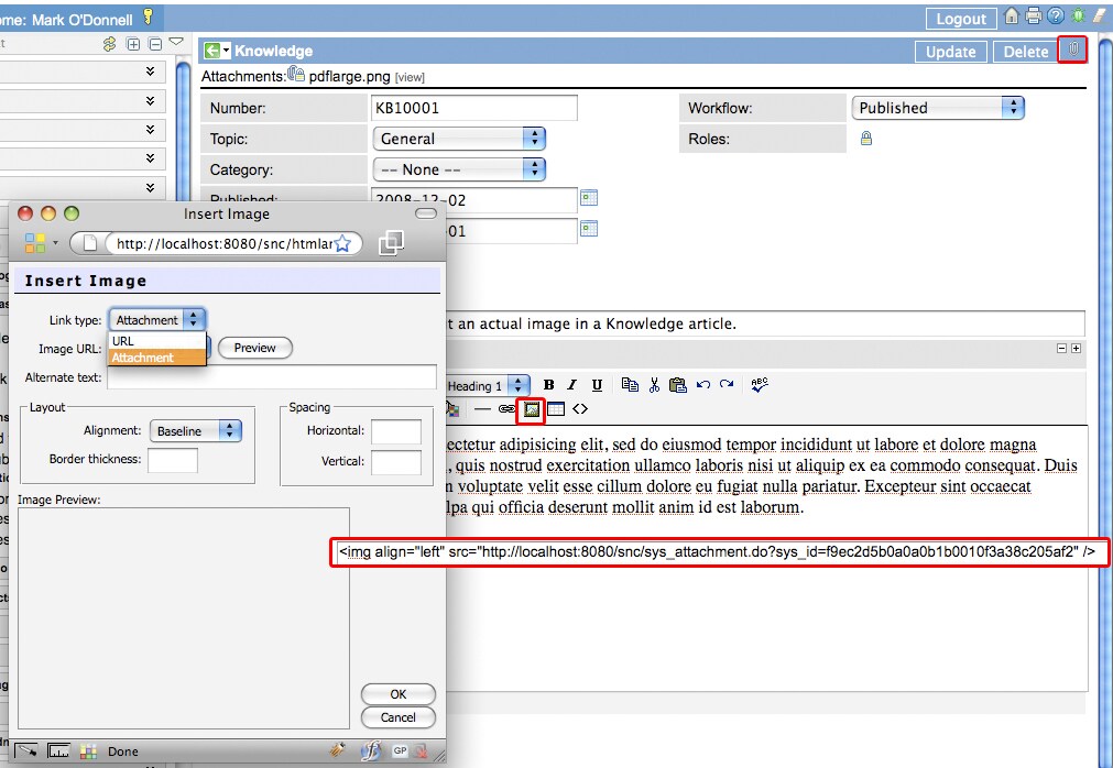

Good question, by using attachments in chorus with the HTML editor it is very easy to add an image to a knowledge article. (Please view the attached screen shot for reference.) I have a feeling that by answering this question it will put a bit more light on the subject of attachments.
Steps to add an image are as follows:
1. Open the article and click "Edit Article"
2. In the upper right hand portion of the interface, click the paperclip icon that opens the attachment screen. Attach the image you need to use for the article.
3. You will be returned to the Edit Article screen, and there should be an attachment listed at the top of the form.
4. In the HTML editor (where you write the article) click the image icon in the editor tool menu. A pop-up window will appear, choose "attachment" in the "Link Type" drop down and your attached image from the "Image URL" section.
5. There is one important finishing touch that we can't skip over, add the attribute align="left" to the image element otherwise your text will not wrap properly. To do this open up the HTML view ( the "<>" icon ) in the HMTL editor, and type in align="left" within the img element.
