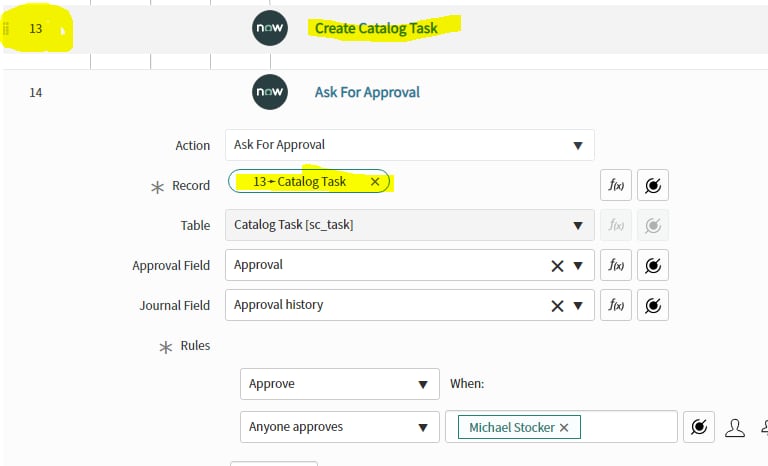

Hello All,
Based on one condition I have to create one service catalog task and want to attach approval to this task.
I don't want to attach approval to the RITM it should be for task. In my case it is not getting attached to this task. Do I need to change the status of task as well before sending it for approval?
PFB attached for your reference.
Priyanka SHIND2
Mega Guru
I got the answer to my question.
We can attach approval to catalog task as well, in my case wait checkbox was checked under catalog task hecne approval was not getting attached to the task
wait checkbox says once this task is closed then go for next step.
