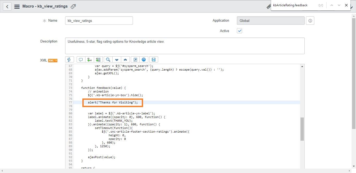

Hi Karthik,
I did find the Helpful message is out of box and here is the way you can add an alert on click of Yes.
Go to UI Macro -> search for XML contains Helpful? you should find this ui macro 'kb_view_ratings'.
within this UI macro you will see that a function feedback is being called on click of Yes search that and update as per below screenshot:
Test it now.
Working fine screenshot below:
Remember that this will be a global change since this ui macro is applicable for all records.

12-16-2017 03:20 AM
Hi Chanikya,
Let me tell you how I found where to edit it. Lucky, this time everything was visible for us users. Sometimes you hit a deadend since it's points to stuff that we can't see and exists only in the famous black box and only for ServiceNow developer
You go to the article, you can see in the url that it's using the ui page "kb_view".
Now go to ui pages and find kb_view.
Looking here, you can understand that the code for the html isn't here, since to mostly just jelly code and javascript.
at the end you see a couple of g:inline. This pretty much means, insert ui macro here. Now the hunt begins. after looking through
the names, kb_view_common seems like a good place, so go to ui macro and find kb_view_common.
and in here.. there is more ui macros.. in the end, kb_view_common_body seem like a good try. lets see that
And another bunch of macros... kb_view_common_footer seems to be the place 😃
And in there.. you got a kb_view_ratings.... lets head there
And here it is... here you can manipulate what happens when you press "yes or no".
