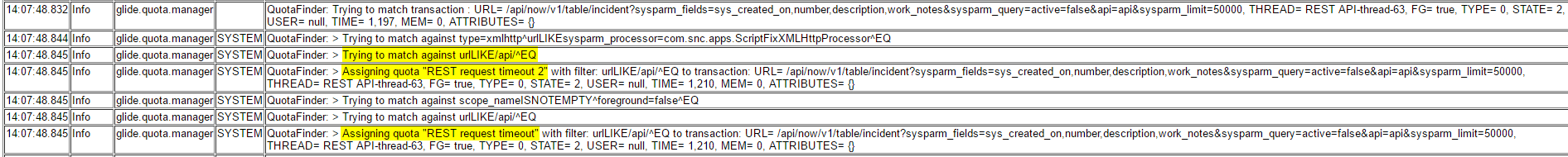

I tested this on my developer instance with the REST quota rule.
First I added a copy of the Rest request timeout -quota rule. I gave it a lower order number.
Then I activated the glide.quota.manager.debug system property and did a large query into the incident table with cURL.
From debug data I could find that both rules were given a "Assigning quota" match to them. The transaction was though cancelled after 1 minute, even though the first rule had a max. duration time of 90 seconds. So at least two rules with identical conditions can not be selected based on the Order value.
Could you add some some conditions to your newly added rule (user value maybe)? Test it on dev/test and see how it goes.
Activate the glide property and I try too see how the rules are evaluated.
