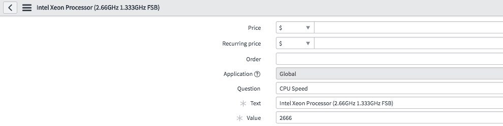

Then you need a price tagged to those quantity. In your choice there will be a Price field, which you can use.
For ex.
I had done similar implementation for a New Server Build Service Catalog. We used to store price in a separate table.
Based on the selection of the RAM, Disk Space etc, I was running an onChange client script and doing the price calculation in the background based on my Price table and then create a record in another custom table. with the final price.
Then associate that record as a reference variable in the Service Catalog. That reference variable should have the Pricing Implication checkbox checked.
This is a solution I could think of.  You may write a Javascript in your widget if you want to use widget only, but then all the other service catalog will also have to use the same widget.
