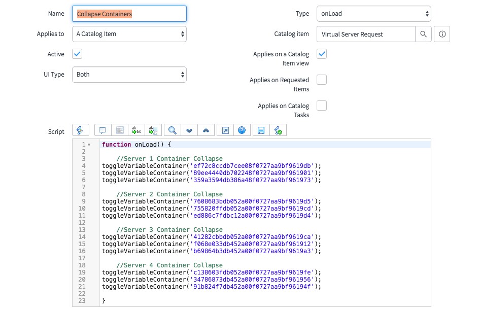

In the Service Portal, the containers are not collapsed onLoad. I unfortunately completed the collapsing using sys_ids and following this thread: https://community.servicenow.com/thread/220129?q=collapse%20containers
I know I shouldn't be using sys_ids to do this but I didn't know of another way how. So maybe that's my issue and it's not the UI policies. The UI policies are setup to show the collapsed variables dependent on the need of another server.
Here's what my script looks like for the onLoad client script of the collapsed containers:
If you have any input, please let me know. I'm really hoping I can get the same functionality working in the Service Portal as it does in the Native UI.
-Marques
Brad Tilton
Ahh ok. Service Portal only supports a subset of the client side methods available in ServiceNow, and unfortunately toggleVariableContainer() is not a supported method. The following link will tell you which methods are supported.
