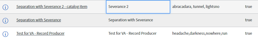

I have 3 test catalogs(2 catalog items and 1 record producers) with Meta tags , short description;

I have tried searching with a keyword Severance  I have expected to have these 3 items in the results but I only got one ,which is the Separation with Severance catalog item only:
