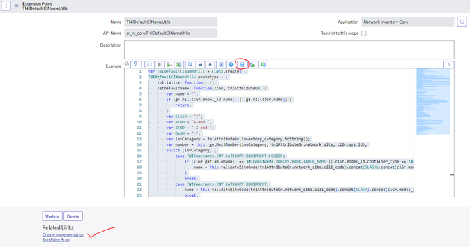

- search for Extension points in navigator. click on Scripted Extension Points
search for sn_ni_core.TNIDefaultCINameUtils
Open this record and update the code: here is the changes I have made to achieve what you wanted.
attaching the complete file for your reference.
Once the code is added, save the code and "create implementation"
Once that is done, you are good to test your changes.

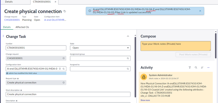

Here is what mine looks like:
