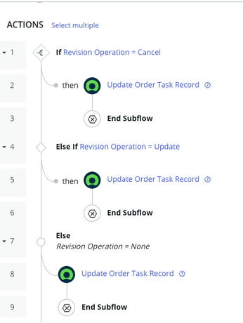

Build a separate subflow for happy path + compensation actions as shown below.
Thus once the Order Task for 'Reserve TN' moves to In Progress, next step will be to call an extension subflow or a Flow (up to you) with the 3 different switch cases for the Revision Actions.
Within the Order Task, you have an option to configure the Inflight behaviour which will tell OM if the Order Task is to be re-executed or skipped based on the type of Inflight Change. If this is not configured, the Order Task will always be re-executed which will call the extension subflow and process the steps based on the Revision Operation (i.e. Happy path v/s Inflight Change v/s Inflight Cancel)

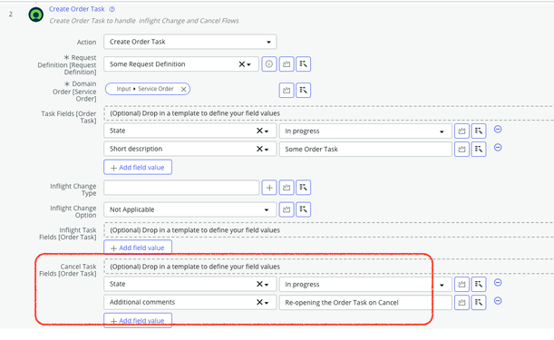

Hi @Gargichatterjee
I suspect you have not configured the 'Cancel Task Fields' on the Order Task. Please check below for an example. If no Cancel Task Field is configured, on the cancellation, for an already completed Order Task it remains in a completed state. The additional configuration will allow you to put the task back in an 'In Progress' state.
Once the Order Task is back in 'In Progress', the extension subflow can be invoked as shown below ->
Extension subflow -->
