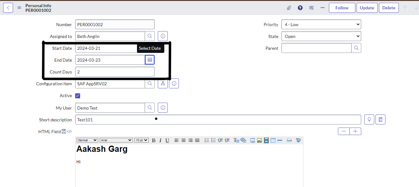

I have 3 fields
 1. star date
2.end date
3. count days
i want difference between dates in 'count days'
Please help us i need code client script & script include also
Thnaks

Hi @basha shaik,
Hope you are doing well.
I tried to find the solution for your scenario or requirement and implement it on my Personal Developer Instance, so that you can easily understand and get the perfect solution in one go.
Solution Proposed
As a solution, you need to create an "On Change - Client Script" and one "Script Include" that will execute the logic or implementation as per the "Last Date" Field changes. Attaching the script that will help you to fulfil your and others requirement via your question asked in the community.
Client Script: -
      return;
   var ga = new GlideAjax('global.GetDaysFromDates'); // GlideAjax Call
    ga.addParam('sysparm_name', 'getCampus'); // Calling Function
    ga.addParam('sysparm_start_date', g_form.getValue("u_start_date")); // Passing Start Date value
	ga.addParam('sysparm_end_date', g_form.getValue("u_end_date")); // Passing End Date value
    ga.getXML(updateCampus);
    function updateCampus(response) {
        var answer = response.responseXML.documentElement.getAttribute("answer"); // Getting Response
        if (answer) {
			g_form.setValue('u_count_days', parseInt(answer));
Script Include: -
var GetDaysFromDates = Class.create();
GetDaysFromDates.prototype = Object.extendsObject(AbstractAjaxProcessor, {
    getCampus: function() {
        var start_date = this.getParameter('sysparm_start_date');
        var end_date = this.getParameter('sysparm_end_date');
        var startDate = new GlideDateTime(start_date);
        var endDate = new GlideDateTime(end_date);
		var diff = gs.dateDiff(startDate.getDisplayValue(),endDate.getDisplayValue(),true); // this will return output in seconds
		// var diff = GlideDateTime.subtract(startDate, endDate);
		var days = diff/(60*60*24);	// converting seconds into days
        return days;
    type: 'GetDaysFromDates'
For your reference, also attaching screenshots of the outputs that will give you better insights of how this script is working or the best thing will be to follow the solution and execute the script on your instance.
If you find this answer/solution/suggestion as helpful to your question asked or meet with your requirement, please do not forget to mark this solution/answer/suggestion as helpful, and correct.
Thanks 🙂

@basha shaik Please refer to this thread https://www.servicenow.com/community/developer-forum/client-script-date-compare/m-p/1503093 where one of the responders has posted client script as well as script include for the date comparision.

basha shaik
Thanks for helping
