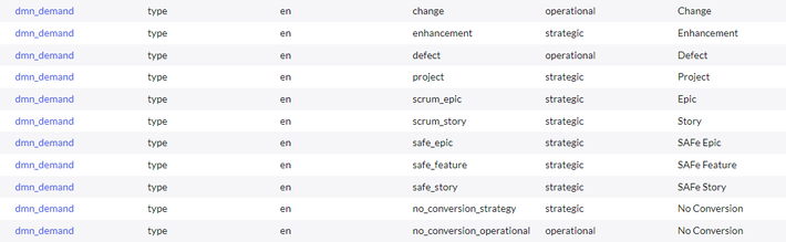

Hi @JBrians ,
According to the table dmn_demand is it the the field type your looking at? If yes, then the blank option should not be avilable OOTB, hence it will neither be available to say that it should be blank:
Below is from the sys_choice table where choice option is gathered:
Also, according to your statement "I also tried using "is not one of", then it will not work. this is due to when mention in a report "is not on of", ServiceNow will say that then it should be something else (NOT blank).

HI @JBrians ,
Please notice that you should utilize the condition:
If you select the operator e.g.
Then ServiceNow sees it as it should be filled with something else than you have mentioned.
