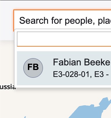

I have worked on several WSD projects now, and on most projects we use something OOTB called Workplace Profiles.
Our plan with this functionality is to attach a space, floor, building, or campus to a profile. When using the Location Directory, it should then preselect the location hierarchy that has been configured.
For example, when you select a workspace or room, it should automatically fill in the campus, building, floor, and then hover to the space itself.
However, for some reason this works on all instances except the most recent one. Is there something I might be missing?
Kind regards,
Fabian ter Beeke
The solution was the Property name: sn_wsd_space_map.map_default_location
This setting can be turned from world map to workplace profile.

Hey @harishk07 ,
Thanks for your quick response.
As of right now, this behavior occurs in the Location Directory – Search tab. When I click on a result, it takes me to the Workplace Profile space. However, on other instances it automatically navigates directly to the space. Could this be a setting that I’m not aware of?
In your response, you mentioned Location Directory settings. As far as I know, there are only Map Properties under Dependency Views and Space Mapping. Are these the only two, or are there additional settings involved?
If you open the PNG “location hierarchy”, it seems to me that the hierarchy is configured correctly. This screenshot was taken from the Region record.
Kind regards,
Fabian ter Beeke
